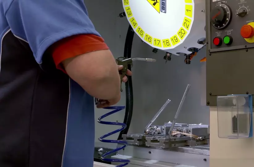

Vedos uses ROBODRILL milling centres that rotate at 24,000 rpm. This is necessary to still get a sufficiently high cutting speed using cutters of 1 mm or even less.Â
“We are specialised in precision mechanical components”, explains managing director Frank Siepel. “We make sealing rings of a few mm, small screws and other fasteners for applications where a very high precision is required. In electron microscopes, for example, all parts have to be perfectly smooth, with a roughness of less than 0.8. Every unevenness would result in inaccurate measurements in such a microscope."Â

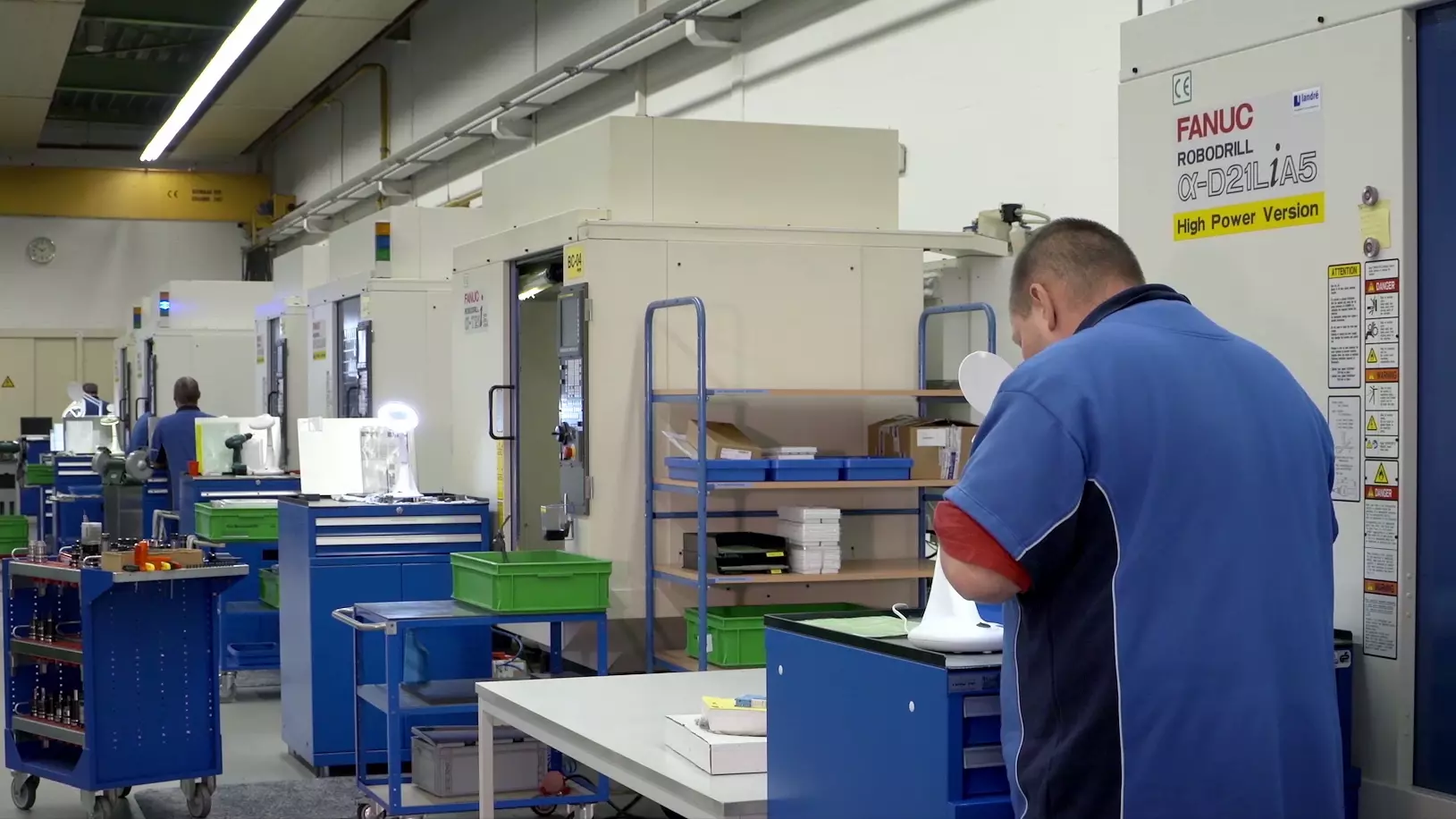

Vedos has 8 ROBODRILL machines manned by 5 operators. “The oldest ROBODRILL is now 10 years old and is still as precise as before," says Frank. Also important in the choice of FANUC is that the machines are very reasonably priced. “Because they are so long-lasting, the depreciation of the machine in itself is no big cost,” Frank Siepel points out. Â
Vedos gives a preference to multiple machines, rather than invest in complex machinery for finishing. “A 12-axis machine may perhaps save time in production but then you have to look out that that profit is not lost when configuring it," says Frank. “Ultimately, the cost price per product counts. If I can have two machines running, it is usually more efficient than if we did everything on a complex lathe with propelled tools."Â
“In order to obtain a smooth surface, we work with very small cutters. Then you also have small grooves that are easy to eliminate. A fast, dynamic machine such as the ROBODRILL is much more efficient than a large, complex multi-axis machine. It depends very much on the nature of the products and the number ordered. If the tolerance of the milling work compared to the lathing work has to be very precise, a combined machine makes sense. But if those tolerances are unrelated, we obtain a higher efficiency on multiple machines without compromising the accuracy.”Â
