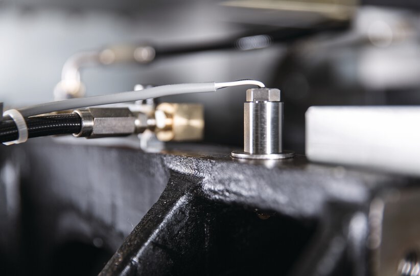

Thanks to its AI Thermal Displacement Compensation function, a combination of multiple temperature sensors and machine learning, ROBOCUT maintains consistent machining precision. FANUC provides a 3-sensor and 7-sensor solution for the small and medium sized models 𝛼 -C400𝑖C and the 𝛼-C600𝑖C. For the biggest model in the series, the 𝛼-C800𝑖C, FANUC provides a 6-sensor solution.
KEY BENEFITS
KEY BENEFITS
Benefits for Your Business
Consistent machining
Thanks to its AI Thermal Displacement Compensation feature, ROBOCUT maintains consistent machining precision even in the face of room-temperature fluctuations
Minimise displacement adjustment
FANUC provides a 3-sensor solution to minimise displacement adjustments for machines installed in temperature-controlled rooms.
Enhanced Precision
An optional 7-sensor solution is available for customers who operate the machine in environments with large temperature fluctuations.
